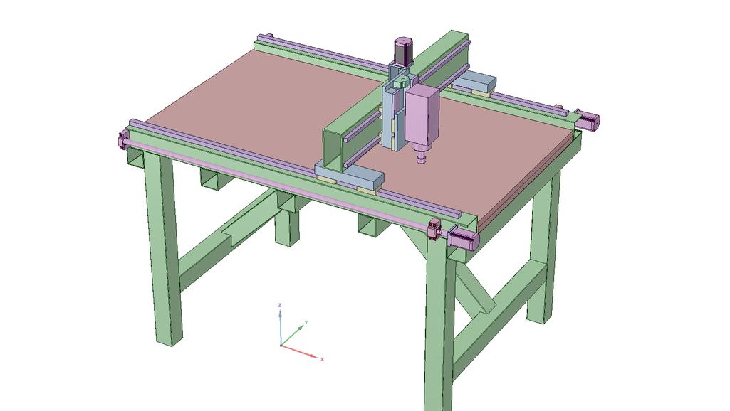

    After investigations i decide to reduce my steel machine dimensions to be 2000mm * 1500mm frame to fit MDF sheet because I concerned mainly with cutting and engraving all type of wood and may be thin plastic only. Of course I am looking for high precision with reasonable speed.
    Working area: 1700mm*1220mm*200mm
    Machine design:
    All machine frame is 100*100*3mm
    the machine will be the same main design like this but with some differences

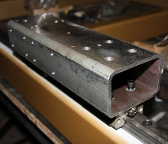

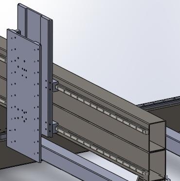

    Gantry will be two welded steel tube 100*100*2mm to reduce the weight, length 1500mm. like this
    Gantry side is 100*100*3mm steel length 250mm like this image

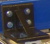

    Gantry attached with gantry side using steel angle brackets in the front for more rigidity and stiffens like this.
    Linear guide: (I choose profiled rather round rails for rigidity and easy to align)
    Profiled linear rails 25mm for X axis HIWIN
    Profiled linear rails 20mm for Y and Z axis HIWIN

  2. By going for 2mm wall section you might have reduced the weight by 30%, but you've reduced the rigidity too by 30% so where you had roughly .045mm per N deflection you now have .067mm per N in the Z direction and 0.27mm per N v 0.19mm in the X direction. Yet another reason why you can't make arbitrary decisions without understanding and considering all the implications.
    Also 2mm does not give any thickness to thread into. ..Clive
    thanks for replay irving2008
    i face some difficulty to understand these calculations. but do you mean that i should use two 100*100*3mm welded steel or one 150*100*3mm for gantry.
  5. Your original plan was to weld 2 bits of 100*100*3 together to give 200h*100w gantry. You then decided for some reason to use 2mm wall section which is lighter but not as rigid. I'm not saying anything about what you should do, just that you can't make random choices without understanding the impact of that decision. You reduced the weight because of limitations elsewhere (although weight can be beneficial against resonance) but you did it in a way that reduced rigidity and it's not clear you understood that.
    3 kw spindle better but not with that gantry sides. Look at my build log #70, same simple gantry sides but much stronger.
    Gantry should be at least 2x 100x100x3 , 150x100 is not a good measure to fit the bearings and at the same time have long Z travel. , try to use only one type of profile, at least thats what i do here, cause i buy 6m lengths.
